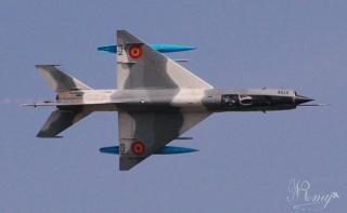

#13 Useril este offline   Romi
  • Postari: 1933
Postat 22 July 2010 - 01:36 PM
new foto
  • Imagine atasata: mig3.JPG
