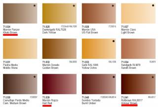

Variante posibile din chart-ul Vallejo:
Khaki-brown sau Hull red sau Armor brown (cele subliniate)
Imagine atasata: Vallejo.jpg
Multumesc anticipat!
#2 Useril este offline   Claudel
  • Postari: 73
  • Inregistrat: 30-August 14
Postat 20 October 2014 - 09:33 PM
Ultima este cea mai indicata Armor brown
#3 Useril este offline   gabrielglodean
  • Postari: 437
  • Inregistrat: 07-August 12
  • Location:Satu Mare
  • Interests:???
Postat 20 October 2014 - 10:10 PM
Din cate stiu scc 2-ul era un maro khaki. Dintre cele 3 indicate,pe net, am mai gasit recomandari pt 24 -le, iar celalte sunt prea rosiatice. Pe net mai recomanda amestecul revell 84:86 (6:5).

#5 Useril este offline   Adila
  • Postari: 90
  • Inregistrat: 11-February 13
Postat 21 October 2014 - 02:16 PM
Multumesc pentru raspunsuri!
Alta combinatie gasita pe net este:
SCC No.2 Brown
Mix: 5 parti XF68 + 4 parti XF3 + 1 parte XF1, unde 68 este Maro NATO, 3 este Galben and 1 este Negru, toate bineinteles Tamyia.
O zi buna tuturor si mari succese in activitatea pe ramura!

Postat 22 October 2014 - 07:53 PM
Ai aici o istorie intreaga a modelului A22 Mark IV Churchill; doua dintre vopsiri sunt ceea ce cauti tu (Model Master Brown 2221
Poate stiai despre chart-ul asta
http://www.tanks-enc...rchill_Tank.php
Cat despre SCC2 Canadian Brown (sau cunoscut in epoca,printre militari drept "brun c.cat de caine") il prepari asa:
S.C.C. 2 (brown, khaki brown or service drab)
Mix: Revell 84 + Revell 86 in ratio 16:5. Acceptable results can be had with Humbrol 98 + 29 in ratio 5:4.
WEM ARB05 is slightly light but can be used on a model as is.
Dyed tilts in S.C.C. 2 can be represented by Humbrol 29 mixed with slight touches of white, black or grey to detail variations in dye.
In use: 1941 – 1945 as basic colour with S.C.C. 1A or S.C.C. 14.
Description: Rich dark brown with a hint of ‘khaki’.
Daca crezi ca este cazul,pune intrebari.
In rest,succes :hi:
